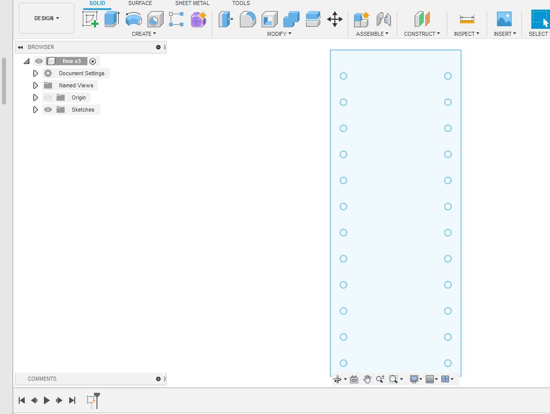

    All parts are ordered. I have built the design in a few different CAD programs, and will share the files for the plates when it is built and verified that everything works as I hope, but here are a few images of the design. The only thing that is not right in the Overview is the Z Axis, as I am still playing with the plates and the design.
    Screen Shot 2020-09-30 at 12.45.04 AM.png Screen Shot 2020-09-30 at 12.48.41 AM.png Screen Shot 2020-09-30 at 12.46.16 AM.png
    The XA Axis plate is:
    This will allow for 8 T-Nuts to attach to the Y upright, and the use 16 Angle connectors. The Y axis is similar, but will have the 4 HGH15CA blocks attached to the plate, and the HGH15R rails will attach to the Z axis. For the end plates of the XAY gantrys, I think I will use 1/4" angle aluminum to tie the top and bottom C-Beams together, and give a good stable mount for the bearing block.
    The stepper mounts I have to say are nice! They incorporate the bearing block and the stepper mount in one unit.
    I hope to start the final build when the last few parts come in later this week.. Maybe, by the end of the weekend, I will have it far enough to play..

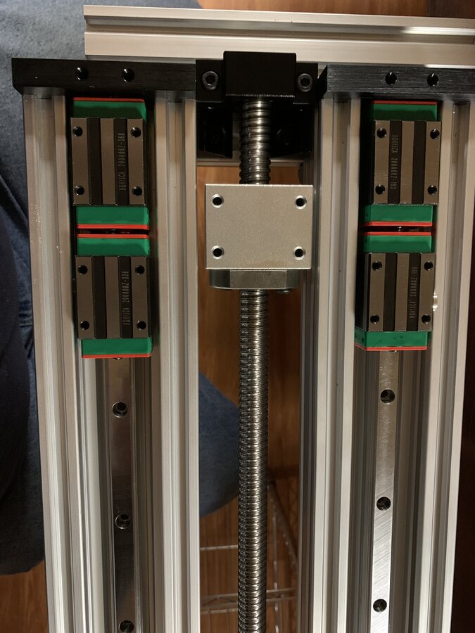

    85% done. So far. No real issue. But I forgot
    To attach the x axis ball nut to the XZ plate so I have to disassemble the z axis.
    0DA9C7E4-9A4B-454A-8F7D-3E117F17F13C.jpeg B037EE7E-9381-4C5A-A19C-3902E6FB1AFA.jpeg
    Giarc likes this.

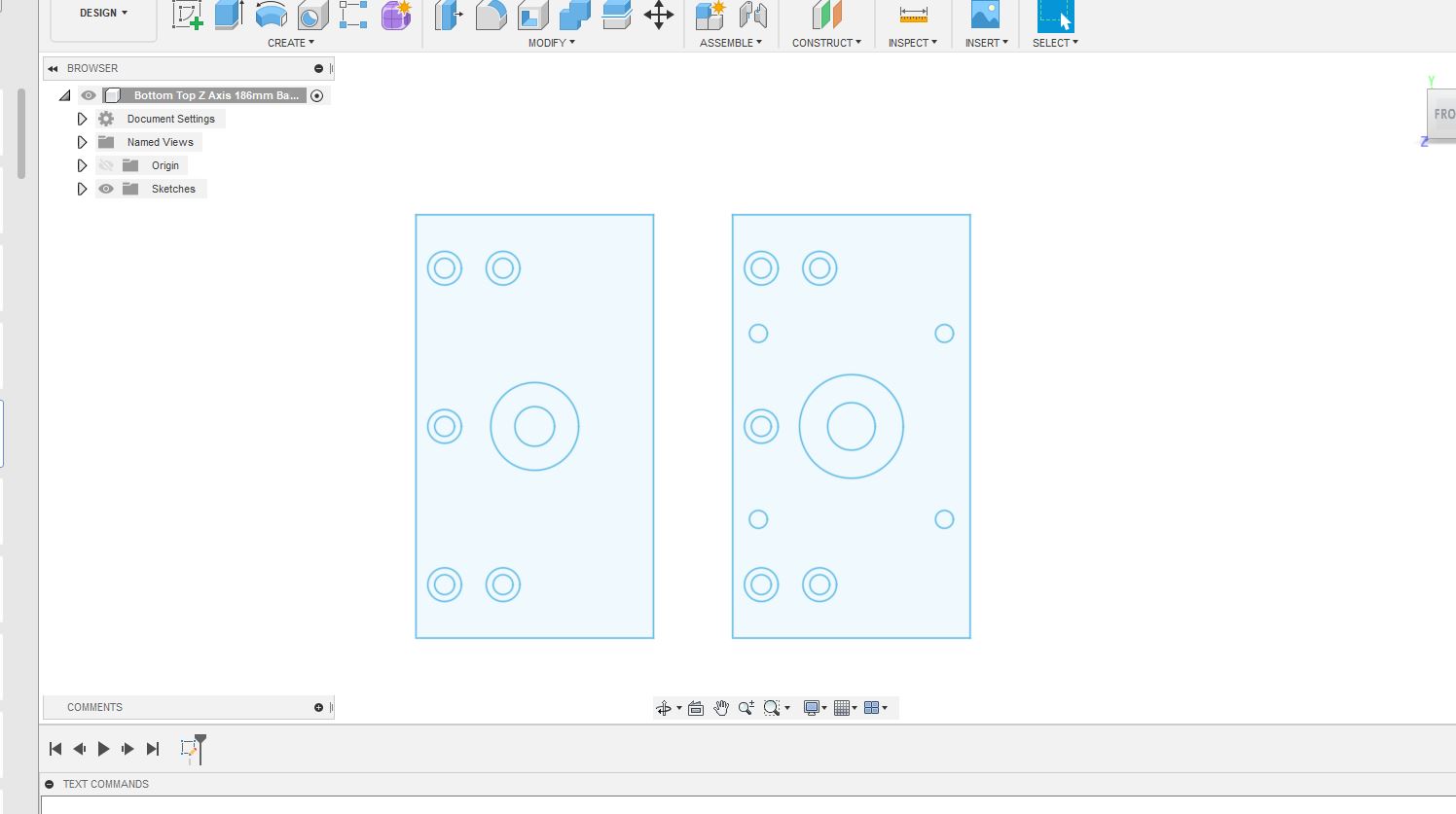

    New Endplates being cut today. I want more rigidity, and this will help. But, now the machine will make its own parts. I will have to make 4 different type of plates. A different plate for the Front and back of the Y/A axis, and Left and Right X Axis. The X Axis needs to have pockets for the connectors where the C-Beam attaches to the uprights. Maybe I will make that connection integrated to the plates, but I need to check clarences. I think the cut-outs will be easier, and still give the expected outcome. Here are the 2 Y/A plates.
    Screen Shot 2020-10-29 at 11.01.57 AM.png Screen Shot 2020-10-29 at 11.01.03 AM.png
    Here are the X Axis plates:
    Screen Shot 2020-10-29 at 11.05.35 AM.png Screen Shot 2020-10-29 at 11.04.58 AM.png
    There is a back plate on the back side of the Y/A plate for the Motor Mount/Bearing block to mount to. These will be cut in 1/2 6061 Aluminum plate.
