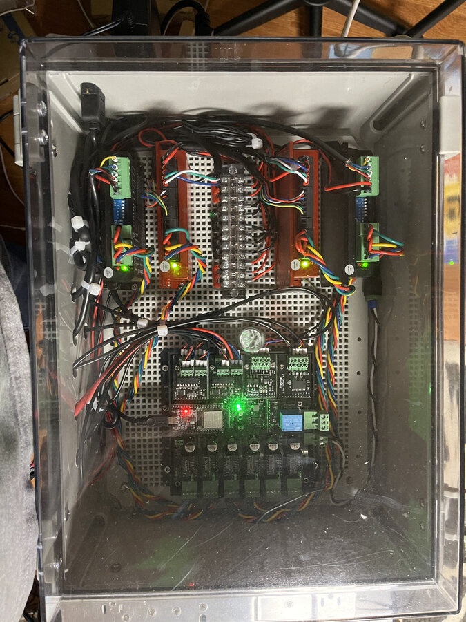

    Building a new controller based off of the GRBL-ESP32 and the 6-pack board. This will allow me to add a rotary A-axis.
    I’ll post more after the different modules come. Changing from a 0-10v control for the spindle to an rs485 and one relay for a 4 pack 5v output module.

    New controller finished. Staying with the 0-10 for now. Added more 5v signal ports. Can now control 5 external IoT devices independently. 4 end stops, one on each of the Y axis so I can do gantry squaring, probe, start, hold, and a enclosure door switches.
    will be installed tomorrow or Thursday night and then we’ll see how it handles the work.
    I have room for 2 more steppers, so I will be adding a rotary now.

    So nice seeing some old school wire-twisting anti-noise strategies :)

    It’s either twisted, or shielded. I don’t want to have problems with emi in a run. And I’ll even isolate the power feeds onto different circuits for the different power feeds. (1 for the 48v power supplies, 1 for the 12v power supply, and the 220v for the spindle.)

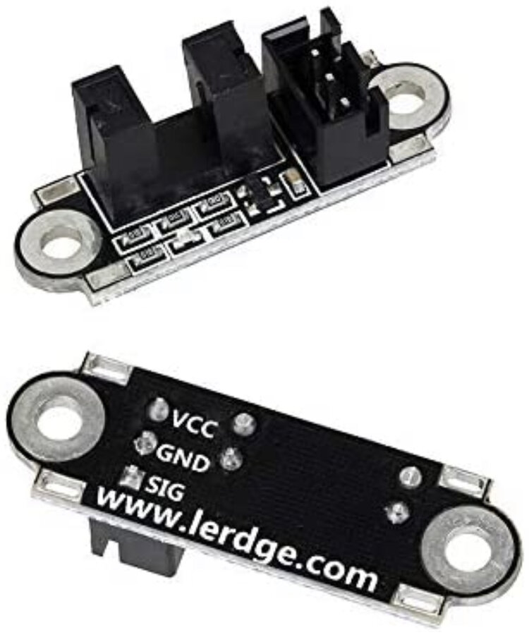

    i am using optical end stops.
    I have one on the bottom of the X axis on both sides to work for the Y axis’s. Just have a small angle mounted at both end on the Y to trip the sensor. For the X/z, they are attached to the X/Z plate and same angles on the X/z axis to trip. These are normally closed, so adds a bit of protection. If there is a switch/wiring problem, it will open the circuit and stop the machine. And, since the switches all have their own signal port, I know which Y axis switch is erroring out.
    as for auto squaring. I’ll let you know when I install the controller tonight/tomorrow. And. A nice thing is that Bart lives in the local area, so if I need something it takes 1 day via mail. Normal snail mail.

    Did a quick hook up tonight of the new controller setup. Ran a job and am happy.
    when I did some initial testing earlier this week, I didn’t like the heat in the enclosure, so I added bigger fans, 2x 120mm, on blowing in one blowing out. Also added 100m40x20mm heat sync on the stepper drivers.
    Need to clean up the wiring but. Temperature is nice. Hottest the stepper drivers got was about 30c, before it was about 48-50c. So big reduction in temperature. CPU on the controller was running about 56c, and now it’s about 48c. Fans for the controller will be here tomorrow.
    I havnt run the full speed yet, and I don’t think I will try to find the max speed. I did a quick back and forth on the Y axis@ 8000mm/min, 0-1300-0 x10 times, and the start and stop position was perfect.
