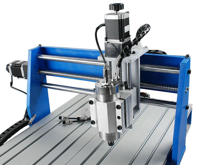

    The Chinese certainly come up with some bad designs - they are probably just fine for cutting foam products but I wish they would not make claims that they are good for hardwoods, metals etc.
    Just as a 'by the way' I came across this design ( V-Slot principle ) which, surprisingly, does work extremely well with a laser (which has no tool loading) but it could certainly do with some improvement to make it last long term. :)

    Hi KYO, pleased you like the steel concept. I agree you can make a better cnc than the x6 q500gt for $1800
    The nice thing about building it yourself is you pick and choose components, size and design.
    After much thought and planning I started to ask myself why use aluminum for the base structure when steel tube is much stronger, stiffer, cheaper and resist vibration more. The only advantage is aluminum easy to drill, tap and bolt together plus you don't need welding skills. I will continue to use aluminum for the X structure to keep this releativrely light in weight.
