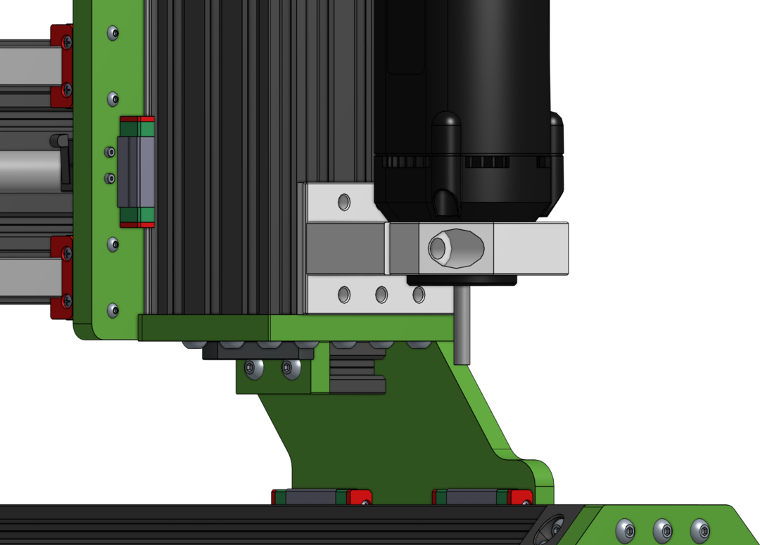

    Yeah. Their friction is really low compared to ACME. ACME self lock. It is related to the weight it takes to overcome static friction.
    I'm not sure how the hobby scene is doing it, but there is usually a DC brake.
    You could just build it and put a wood block under the Z when the machine is off. :)

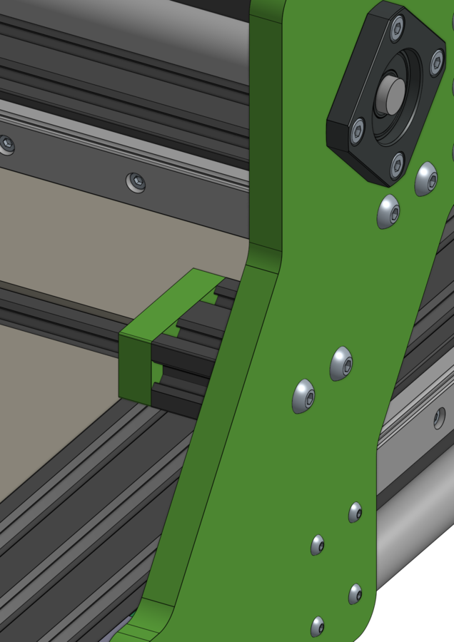

    Thanks for your advice. Regarding the Z-Axis dropping, I added a little stand on the X plate where the Z-Axis can go resting outside of the work area.
    It allows me to implement a macro to go there, which should be more practical than the block.

    That's a really nice idea if it does drop.

    Ok, I published the STEP file, the export might not be perfect but I hope it helps.
    Regarding the slot, it is meant to pass the endstop cable, as shown in the picture.
