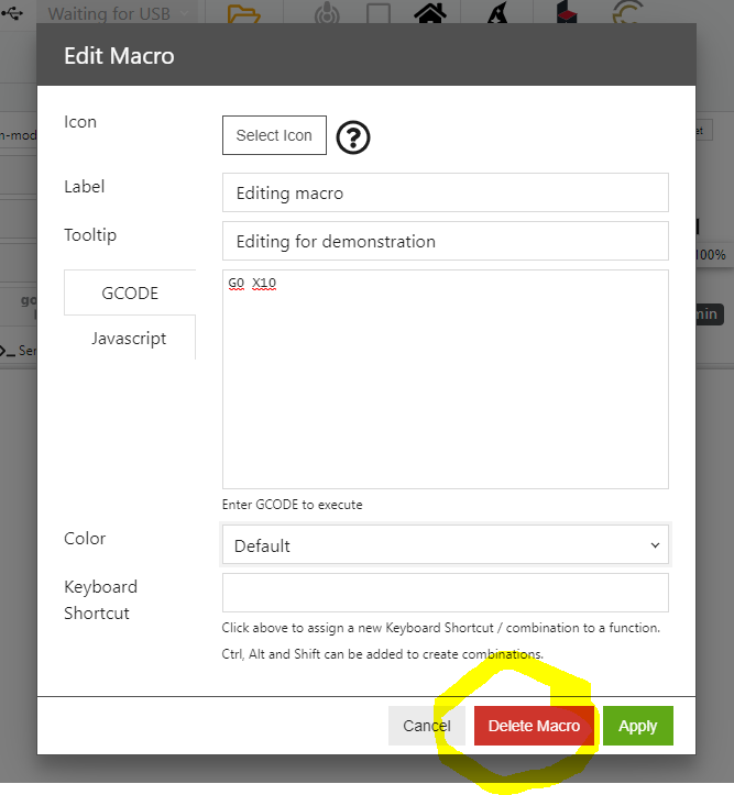

    How do you delete a macro, seems to be no option on the macro tab other than ADD.
    I created 5 macros through the web interface expecting that they would show up under the app running on my shop PC and when I went out there and opened the macro tab there was nothing.
    I then went back to my office PC and opened Control again in a browser and all 5 macros I added were gone.
    Is there something special that needs to be done to make these addition persistent?
    Where are the macros stored on the PC running the app and where are they stored if created in the web interface.
    Builder Resident Builder
    15,700
    4,502
    Localstorage in the browsers - each browser on each machine has its own private store. It cannot propogate around to remote windows. Remember, primarilly CONTROL is a desktop application. The webserver is actually for the mobile jog widget, and the full view is available as a courtesy. Recreate macros where you want them.
    Its persistant where you create it.
    Edit it using the little gear icon, on the Edit window, as a delete option:
