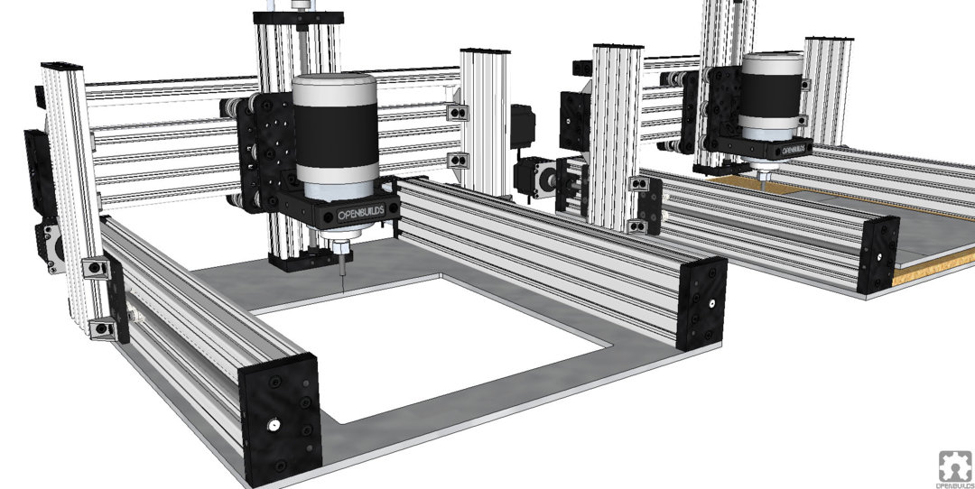

    Not sure you can get down to the $500 to $700 range when you start figuring in VAT but you should be able to get down reasonably close if you can handle cutting your own starter plates. As far as shipping, there are a number of OpenBuilds distributors in Europe so you don't need to ship all the way from the US.
    Attached is a rough concept of what I was talking about. It's just a modified version of something I already modeled and could still use a lot more simplification to bring down cost. But it would allow you to through-cut in sections on larger items and cut smaller items or acrylic on an inset waste board.

    One question, not sure if it's relevant, but I notice that when using lead it is C-beam that is the choice and then the wheels are inside the beam. When using belt (like the OX) then the wheel are on the outside. I'm thinking wheels outside (on for example the v-slot 80mm) will be much wider apart than inside a c-beam. Should that bring ore stability than wheels on the inside? So, what happens if you use the c-beam but use the wheels on the ouside for x an y also (just like the OX do on the Z).
    Wheels outside or onside, does it matter for stability and what materials that can be milled?

    Another option in addition to trochoidal milling/adaptive clearance strategy is the use of proper roughing/finishing passes. This would require a simple tool stickout setting jig or zeroing plate, but it's amazing how much material you can push a large diameter roughing end mill through compared to a smaller finishing end mill, with lower cutting forces and higher feed rates.
    Wheels as far apart as possible for minimum deflection- because it's a direct product of the torque on the frame from the cutting forces being overcome by the rigidity of the beams, plates and wheels themselves. The further apart the wheels are, the less force they need to apply to overcome the torque (T=Fs and all that) and therefore the less deflection force they see on themselves. Obviously this ends up being a compromise between rigidity and machine size & axis travel. You've just got to pick a point you're happy with.

    I understand your concern on the internal wheels but wheels on the inside are fine in this case due to the counteracting wheels on the far end of the gantry. While the narrow gauge would tend to allow an individual plate to roll inwards, the rigidity of the gantry frame combined with the wheels at the far end prevents this inward deflection from happening. (You'll note I didn't use the internal wheels on the Z-axis, something which is fairly common in designs here on OpenBuilds. I don't trust internal wheels in single plate applications.) The inset wheels also work better in this case because it allows for easier bracing of the side channels, which help prevent them from rolling inwards.
    As far as belts go, using both internally mounted wheels and inset belts is possible on the C-beam. It just takes a bit more coordination in the plate design.
    While belts can be used on systems used to cut aluminum, lead screws offer more power and a better resolution on the cut.

    The gantry plate for a c-beam in the shop. Can I just add an other c-beam to that (like in the design above) or do I have to create my own custom side plates to anchor the Y beam to the X beams? I will create a machine with a movable gantry and a small area (so I can move the machine) like 400x600 active area) and it will need to be able to mill Acrylic up to 10mm and Aluminum up to 10mm . But I don't dare to order any parts (plan to order in a little at a time to get the hang of it) but don't want to order stuff that I can't use.

    If I'm following what you're asking, yes, C-beams can be used for side vertical risers. There are already several examples of this on the forum. The design above (with the exception of the big metal base plate) was created around the idea of no special or user cut plates. Everything can be obtained from the OpenBuilds parts store.

    Will the "ordanary" C-Beam Gantry Plate work (wide enought?) to fasten C-beams vertically with the angled brackets / like in your example or will I need to get the Gantry Plate XL to have enough space to fasten the vertical c-beams?

    Actually the plates shown are C-Beam® Gantry Plate - Double Wide which are wide enough. You will need to use Cast Corner Bracket clips though to compensate for an odd hole spacing at the center of the plate.
