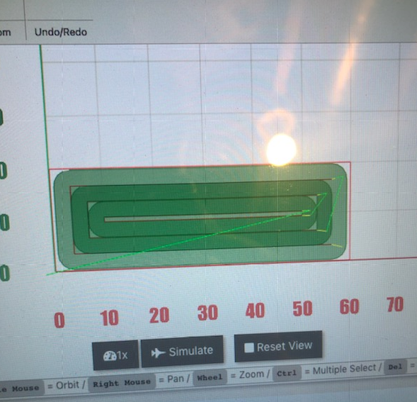

    I made a simple rectangle in the CAM program, pocket tool path looks good.

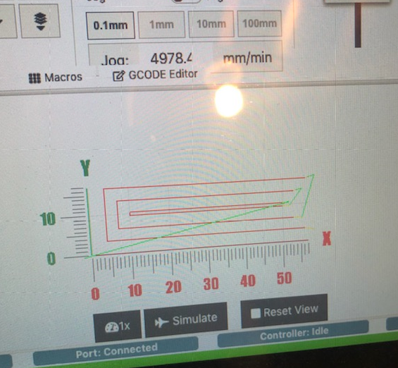

    Transferred over to CONTROL and it now looks like this:

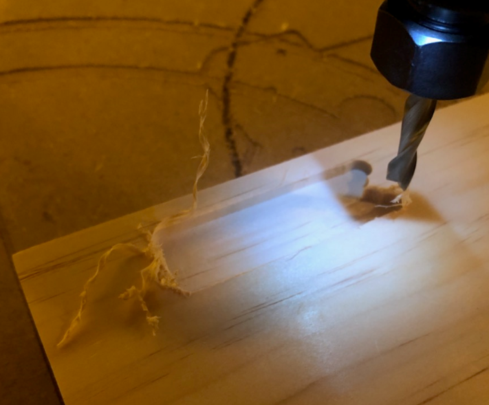

    I decided to try the cut anyway and sure enough, it did just that.
    Not sure if this has been reported already or not, but thought I'd bring it to your attention.

    Yip was fixed in OpenBuilds CAM a couple days ago already: see Open Builds CAM:G Code Generator problem and the Changelog inside CAM on the settings tab :)
