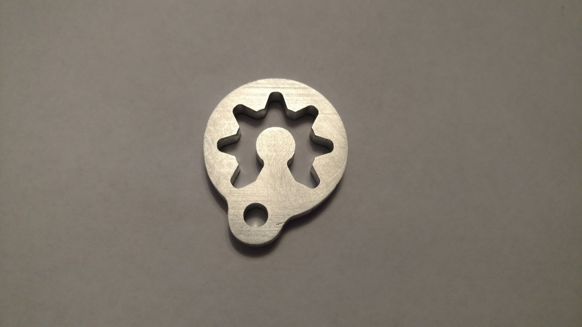

  7. Kyo
    Kyo Veteran
    Feb 27, 2014
    674
    707
    Hello Davus,
    Here are the details I used to cut the Aluminium version.
    16,000rpm
    40ipm
    0.015" depth of cut
    40% Step over
    Endmill used was. 1/8" flat nose single flute upcut carbide

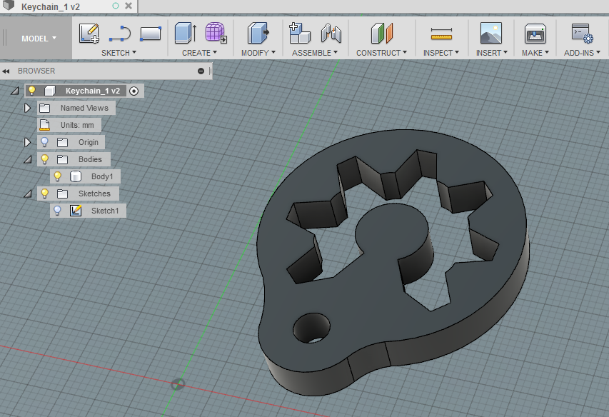

    Kyo,
    Love this project!!! Any chance you could export this file in a step format or anything else that might work in Solidworks!?!?
    Thanks,
    Sonny
  10. Kyo
    Kyo Veteran
    Feb 27, 2014
    674
    707
    @Sonny Lowe Thanks, Sure no problem. I went ahead and redrew this Project in Fusion 360. Some of the arcs differ from the first iteration otherwise same design. Here is a Step export as well as the source Fusion archive file.
