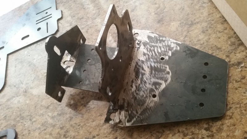

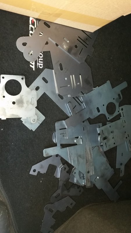

    Received the set of carriage parts lasercut from gorgeous 3mm mild steel:
    And as soon as I got home, welded one up. Now, note I have only owned my first stick welder for approx 3 weeks at this point, and have only done one quick project table as practise. So the welds does look crap - sorry :) - a few years of practise ahead

    First of all, your welding. If it is structurally sound, in this sort of environment who cares. Actually if you paint it or have it powder coated it will help hide what YOU don't like. If you are going to be doing much of this sort of welding in the future, consider getting a mig wire welder. It makes welding for us "hacks" much easier. Now a question if you don't mind. Who did the plasma cutting for you and how much did it cost?

    To answer your question first, the set of parts cost me $60 to get lasercut (but if you view my Freeburn2 build on here as well - according to the forums I get metal lasercut at half the price the rest of the world pays. One of the pro's of living in the 3rd world I guess)
    Regarding Mig. I picked up the literally cheapest machine I could find. $90 for a brand new 200A Inverter with 12month warranty from a clearance warehouse. The cheapest Mig they had was $340+-
    Now I do agree the investment would be good, but I have seen experienced stick welders do great jobs. I am just splashing more than beading (; though putting todays job next to the first weld I ever made (blow through mess) - I'd say give it 6 months (;
    However, anyone have anything good to say about flux core Mig? I cant really rent a argon bottle for $20/month considering how rarely I actually use it...
    If its OK, i might consider trading in the stick. That was the big turn off for me, having to get a large bottle...
