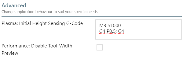

    Loving the simple CONTROL CAM for my plasma cutter, I am starting to tweak the settings to make it work a little quicker and more efficiently but ideally need a pause before cutting the shapes so the arc has more chance of initiating. Is this possible? I can do this on SheetCAM but haven't bought the software so am limited on the number of lines possible, unless there is other software that's free or cost effective?

    In CAM -> Settings > 6 Advanced > Plasma Initial Height Sensing Gcode we can hack in some extra commands:
    M3 S1000 ; turn plasma on
    G4 P0.5; G4 = dwell, pausing in place for P0.5 = 0.5 seconds, change 0.5 to however long you want to pause in place
    (this will have two M3S1000s in the gcode but the second one will be ignored by Grbl so all good)

    Thanks Peter, just to confirm that this is correct? As so far it ignores the extra code!

    Its supposed to ... :) I use if for actual height sensing on my floating head with:
    When you look at the gcode output is the extra commands not present?
    If you could check for me, I havent actually used the Plasma in a while so let me know if its not and I'll dig in then

    Oh, and since not all machines have/need IHS and we are hacking IHS for your use case:
    Remember to enable IHS (Initial Height Sensing) in the Operation too

    Perfect thanks, I will try selecting the IHS later but looking at the G code it looks like that was the issue here, thanks again!

    You need the checkbox on for it to include the commands

    Yes that's perfect its the check box that I missed! Will try it later hopefully!
