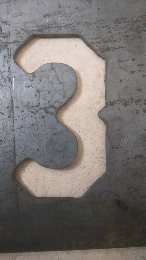

    317
    My best result is in Mild Steel 3 mm , speed 2500mm/mn , arc voltage 125V , torch height 1.2mm
    [​IMG] [​IMG]
    also good in mild steel 5mm at 1400mm/mn
    Plasma cutter in an Hypertherm PowerMax 45.
    I'm still searching good setup to cut aluminium .

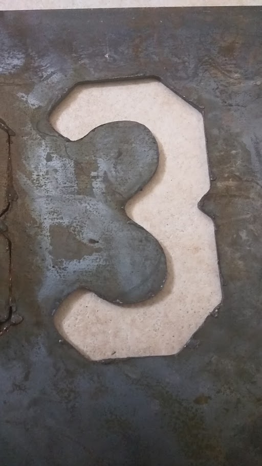

    this face has no treatment ( except it's painted ) , there were some dross on the other side , but really easy to clean.

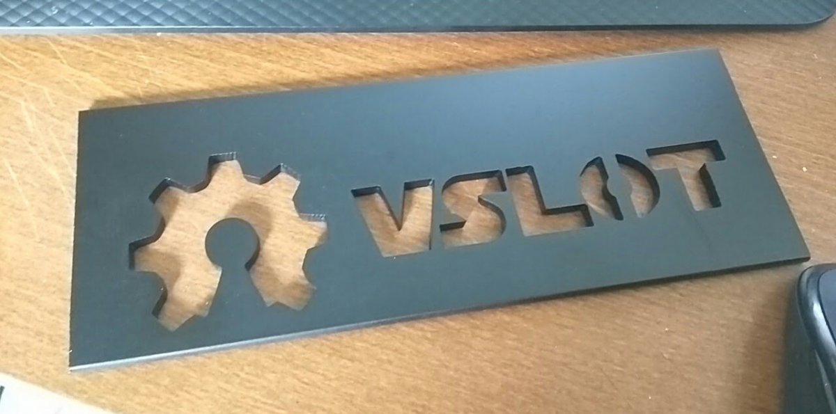

    some of my works done with this cutting table
