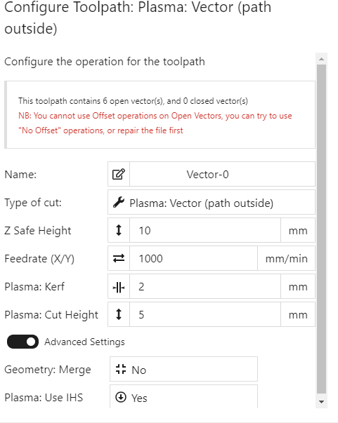

    Hello i tryed to mke a G-code for a plasma but when i tryed to put a tool path the sistem told me this
    What did i do wrong, maybe my .dxf file is not good?

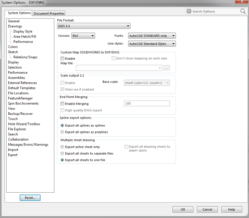

    Guessing from the screenshot: file format DXF (Not IGES), turn Endpoint Merging on, splines to polylines.
