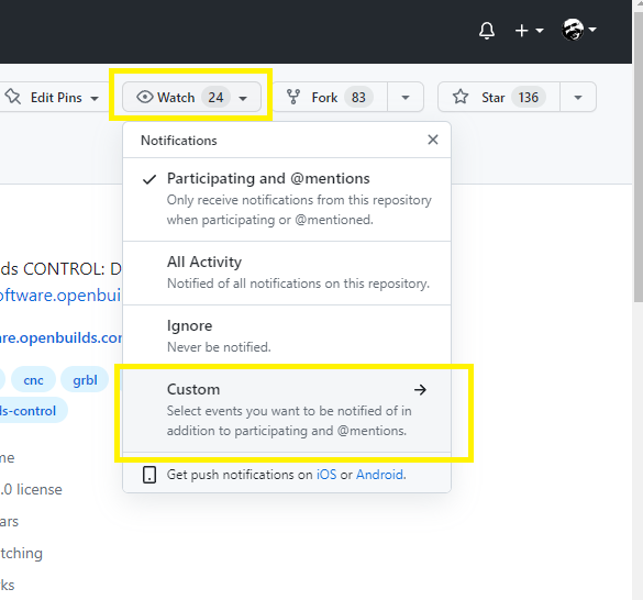

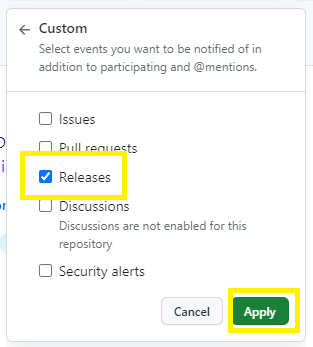

    Not likely on the forum, but you can use Github:
    Go to GitHub - OpenBuilds/OpenBuilds-CONTROL: OpenBuilds CONTROL: Download from https://software.openbuilds.com
    Click the Watch icon along the top > Select CUSTOM
    Select RELEASES and Apply
    Github can send you these notifications as emails: Configuring notifications - GitHub Docs
