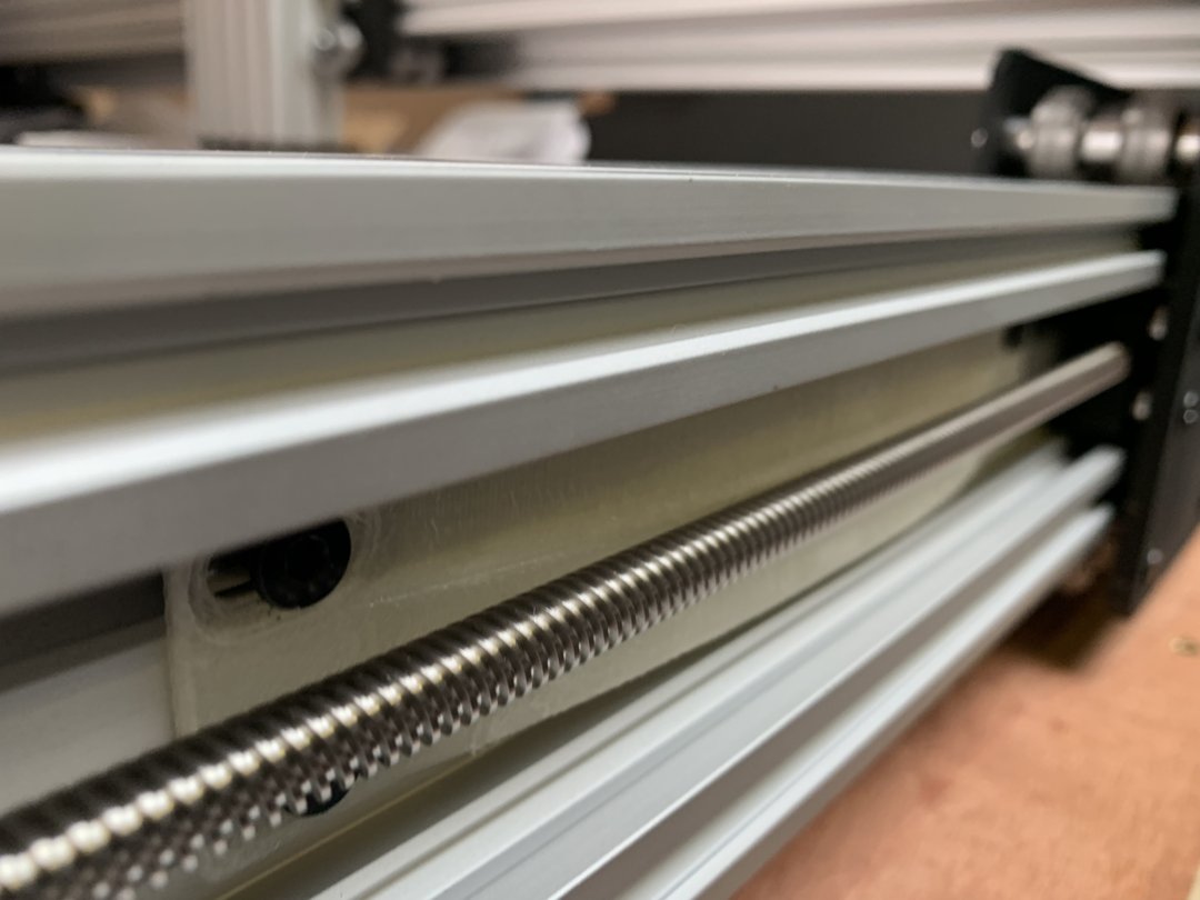

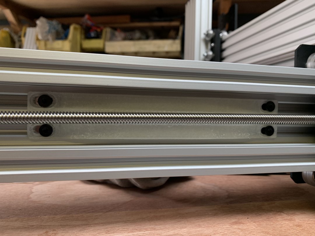

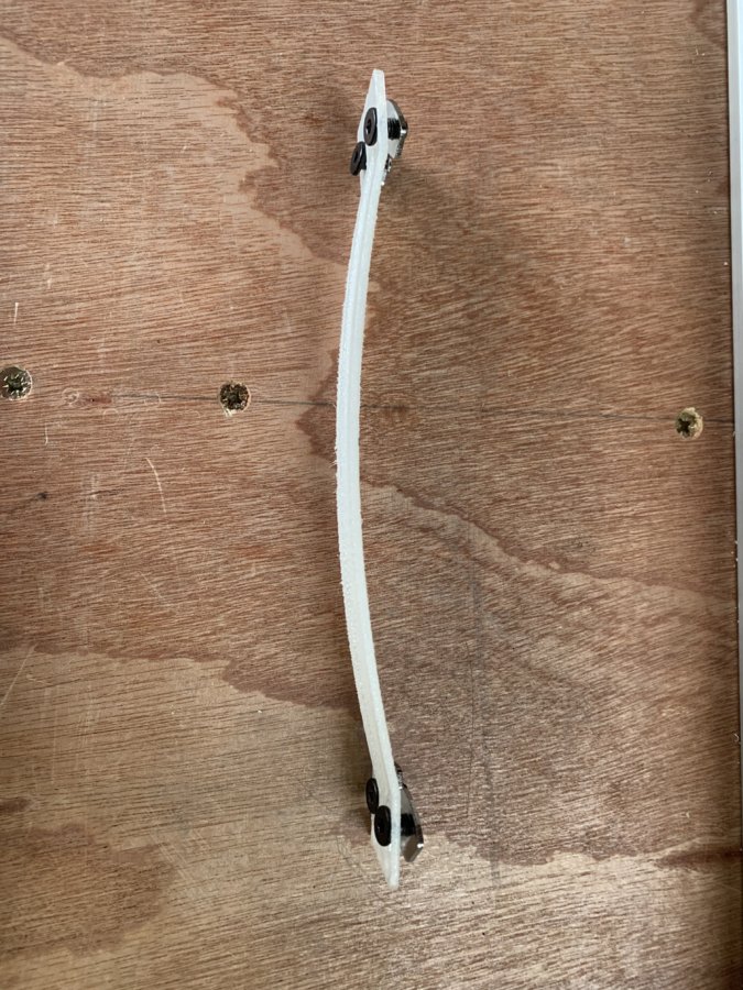

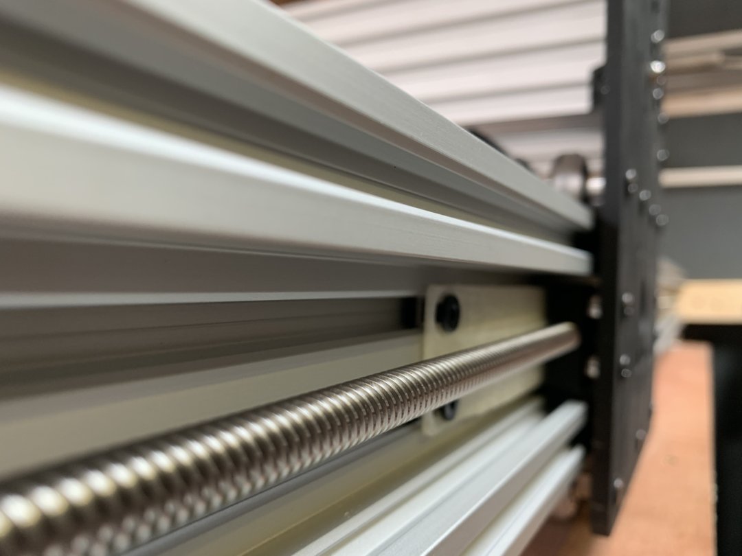

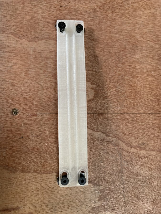

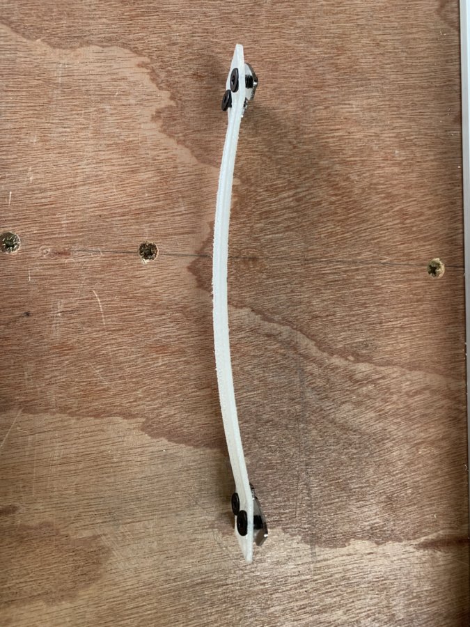

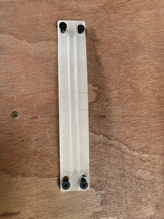

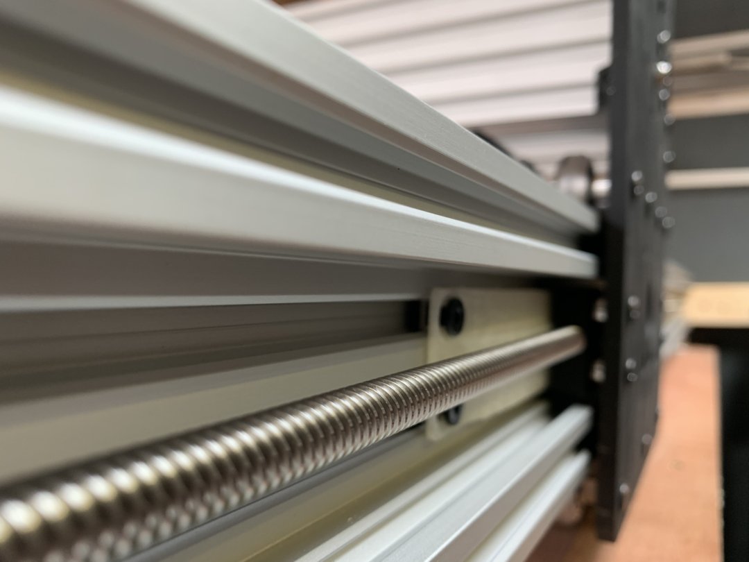

    B23B9996-F63D-45A2-AAF8-4B8B0FE0B6F6.jpeg 239D96CF-FBC2-4ADD-9C9E-92DC3C5FAB78.jpeg 9E2F5BFB-E0A8-4B7C-823C-33E0A21DD626.jpeg 8C197534-B4AF-41F0-A0BB-CA144271D5F6.jpeg F2087AE3-6C4E-487E-B8C3-039BB3F21F7E.jpeg
    Fusion 360 link for download
    A360
    Printed the guide springs with Taulman3d 910 nylon.
    Change the bolts that are in the screw blocks from 25mm to 20mm so that they do not protrude on the inside of the block.
    Fit 4x 8mm low profile bolts and 4x knock in tee nuts this allows the spring to move on the bolts as they bottom out on the extrusion.
    I have 2x on each side as it’s 1000mm x 1500mm machine, but I think 1 would be fine on 1000mm x 1000mm machine.
