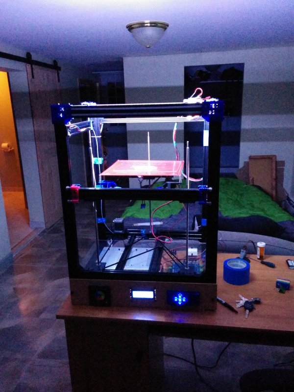

    Got some more construction done, It is essentially mechanically built.

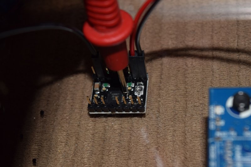

    Got my drivers set up tonight. I am using the 4988 blacks, to make them compatable with the mightyboard i had to solder them upside down. Needed to use some jumpers to access the trim pot. Jetguy's answer to my question about setting VREF. "If so, most of them use 0.4V Vref = 1A so just multiply your value in desired Amps times 0.4V= Vref. So 1.5A= 0.6V Vref , 0.8A for the extruder is 0.8*0.4V= 0.32V Vref

  10. Joseph Ecker
    Apr 5, 2015
    30
    Hello,
    Would you have a link to someplace that describes the process of getting the 4988 drivers connected up to a mightyboard? Unclear about the "needed to use some jumpers to access the trim pot."
    I've been studying your design as well as the C-Bot...
    Thanks much

    I'm not sure why these pics didn't attach the first time. Basically I used a m/f jumper to connect the driver to the MB. two of them, one on ground and one on VDD . Another jumper from the other ground to my DMM, aligator clipped. You measure the VREF at the pad that I circled. The worst part of the operation was having to power cycle inbetween drivers. DSC_0423.JPG DSC_0425.JPG DSC_0426.JPG a4988_pic.jpg

    i thought i had posted this as well. remove the pin in the MS3 slot, then solder bridge to MS2. I should have rotated the inverted one to show the missing pin better. The close up in the post above shows that pretty well. DSC_0412.JPG

  13. Joseph Ecker
    Apr 5, 2015
    30
    Oh, so you hook up the driver with jumpers, adjust the trim-pot and then attach the driver to the mightyboard?
    I think I've got it :)
    Thank you very much for the great pics!

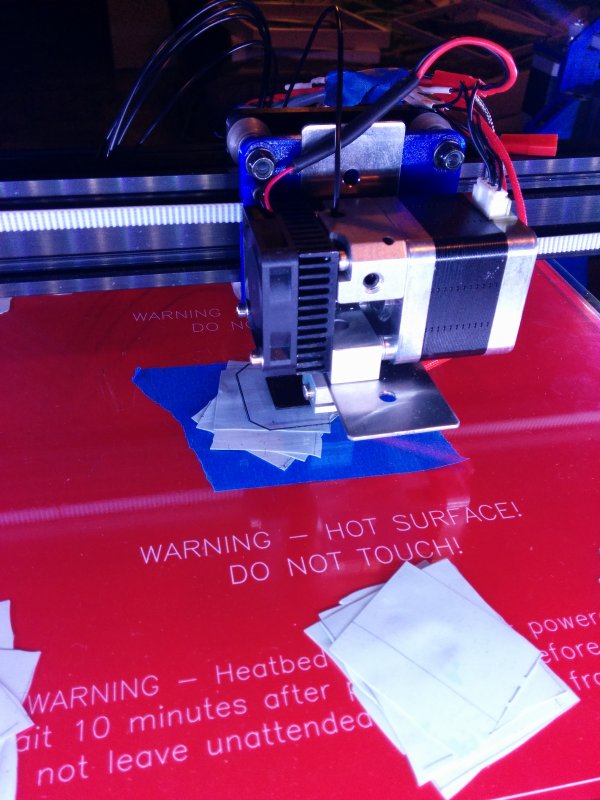

    Printe IMG_20150420_000214:nopm:.jpg IMG_20150419_220608.jpg d my first cube tonight. Borked my first stepper driver tonight. First print had some belt tension issues. I think my ssr for my heart bed is defective also. Full time on with no input signal. The HBP heats up very quickly.

    My 40 amp FOTEK SSR I purchased from Amazon also died within an hour or two of use. Let us know what you end up using for a replacement as I'm still using my Azteeg X5 directly for a 160mm heated bed.
    How do you like the MK8 extruder setup? Can you post the mount design? I'd like to give one a try since some of the Makerbot 2's print quality I've seen have been really great.

    It turned out to be user error with my ssr, the output side is directional. + is input -is output side. Once I hooked it up properly it functioned fine.
    The mount for my extruder is just a universal dual extruder mounting plate, with a90 degree bend in it. I plan on replacing that with a aluminum right angle. Pretty easy mount. I will post some photos when I can, the bot is currently behind a wall of moved boxes.
    The short, all metal, stepped thermal barrier is the best in my opinion. You get actual retraction, and coupled with sailfish you get best print quality on8 bit. Driving one direct drive stepper around with two kysan's should be no trouble, my clone uses one .8A stepper to move my dual extruding carriage.p

    It has been a long slow process getting the last little bits straightened, and nit picky fine tuning. I finally have a nice flat plane to print on. I got the 300mm aluminum plate from lulzbot and mounted my PCB under it. I think i will use some 1mm ginopads to allow some expansion differences in the different materials. I need to make a support brace, holding the pcb against the bottom of the plate, the same sag that was causing me grief with the glass has returned, under the aluminum the only problem is low thermal conductivity. Luckily I just made nice with an employee at instructables who might be able to get me some flo-jet time. order up a k shaped brace to support the pcb and clear the thermister.
    next bug to squash, finding center offsets for slicer calibration. I need to run the centering script from repG, sailfish displays the information on the LCD. That information needs to go into S3D.
