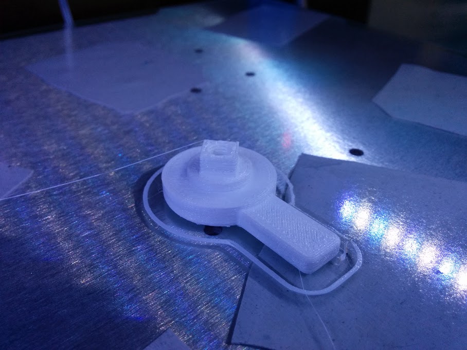

    The part printed in red was the modified car that used with my z endstop. The original C-bot used different style switch, and mounted to the rear Z slider. When I found the mini endstop switches I used that to mount directly to the vrail and trip on the car.
    I attached the idlers from Carl's thread, idlers and motor mounts are the 4 common parts

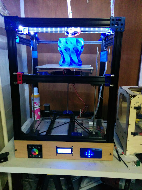

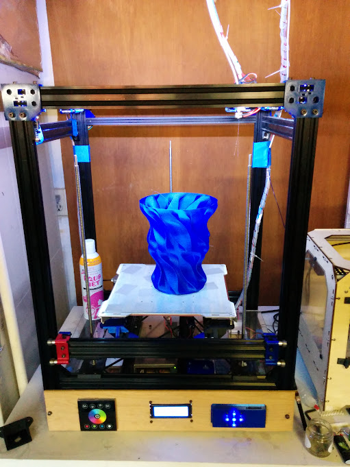

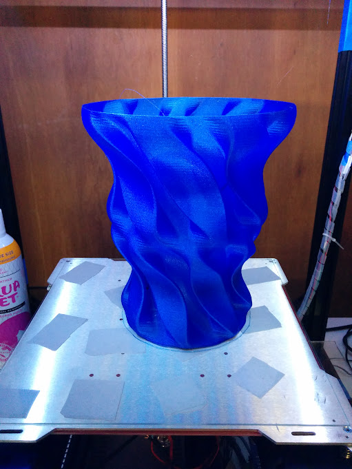

    Have been using the Triple-C a bit more these days, the little gremlins to chase are getting fewer and fewer. My neighbor came over with a broken screen door handle, and said " what can you do about this?" 45 minutes later...
    A single wall vase, eSun PETG printed at 245c/70. 85mm/sec
    [​IMG][​IMG]

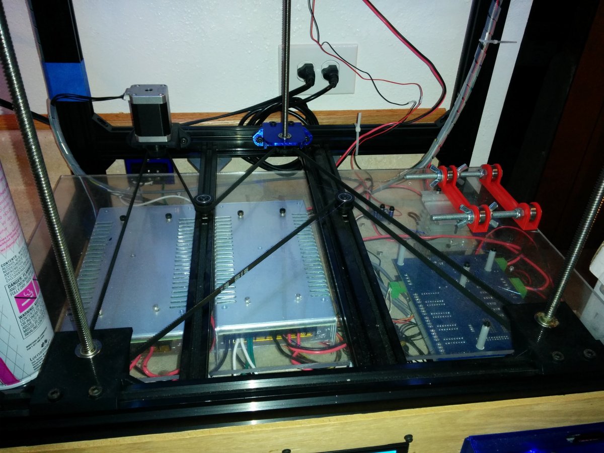

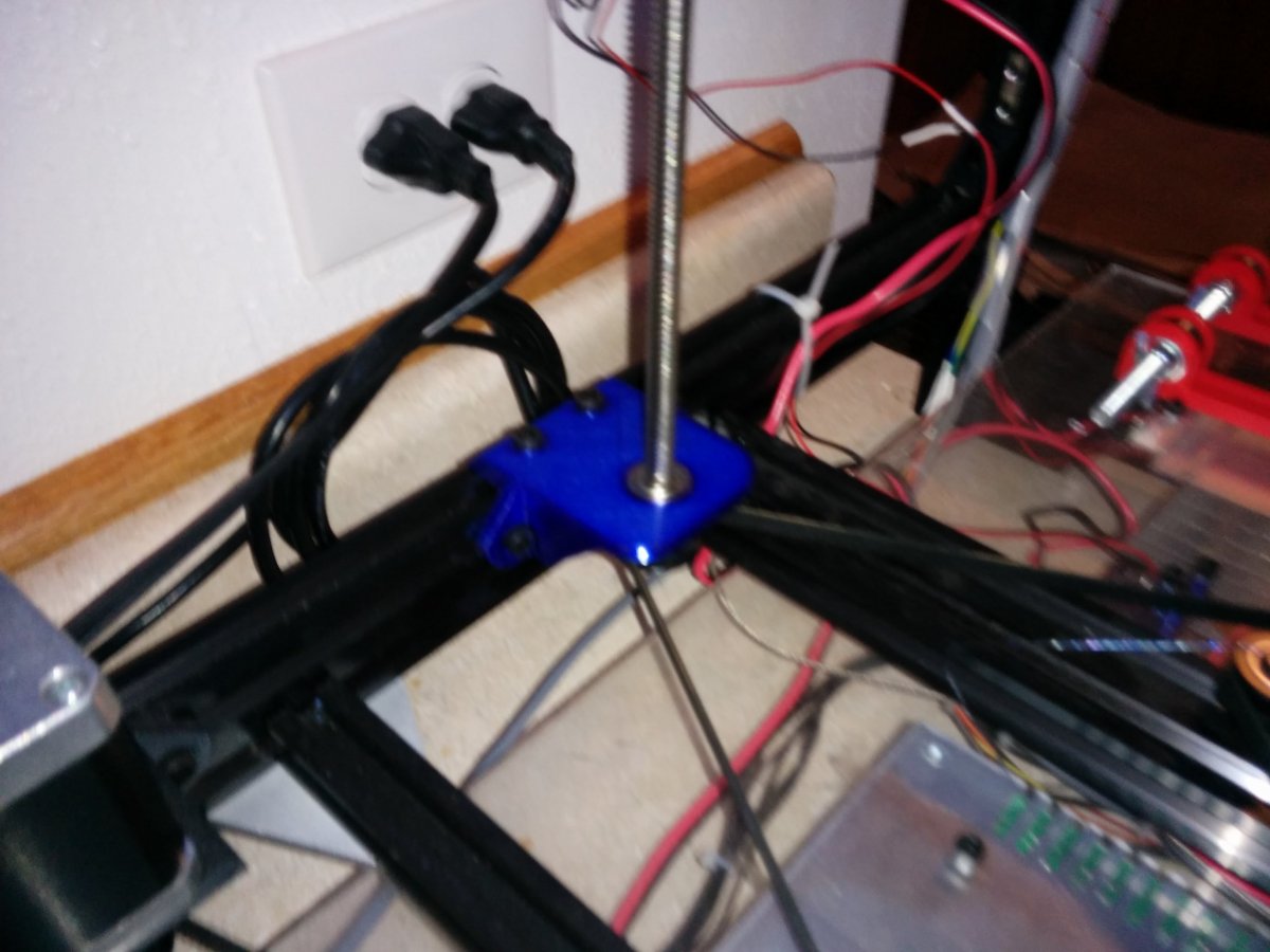

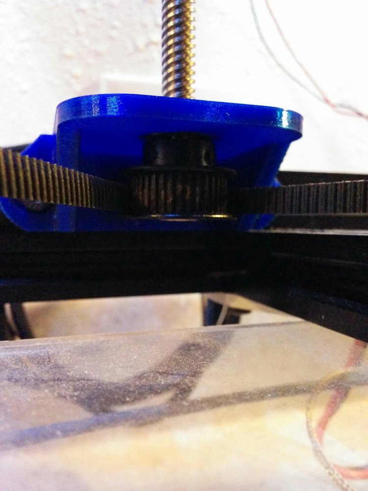

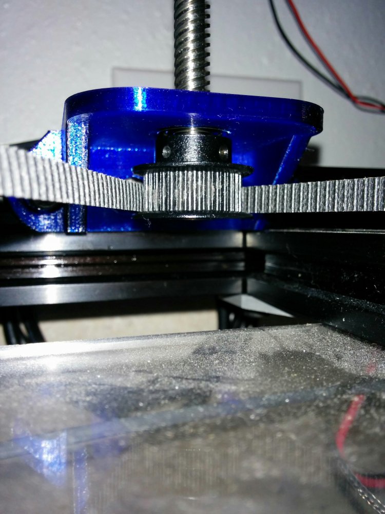

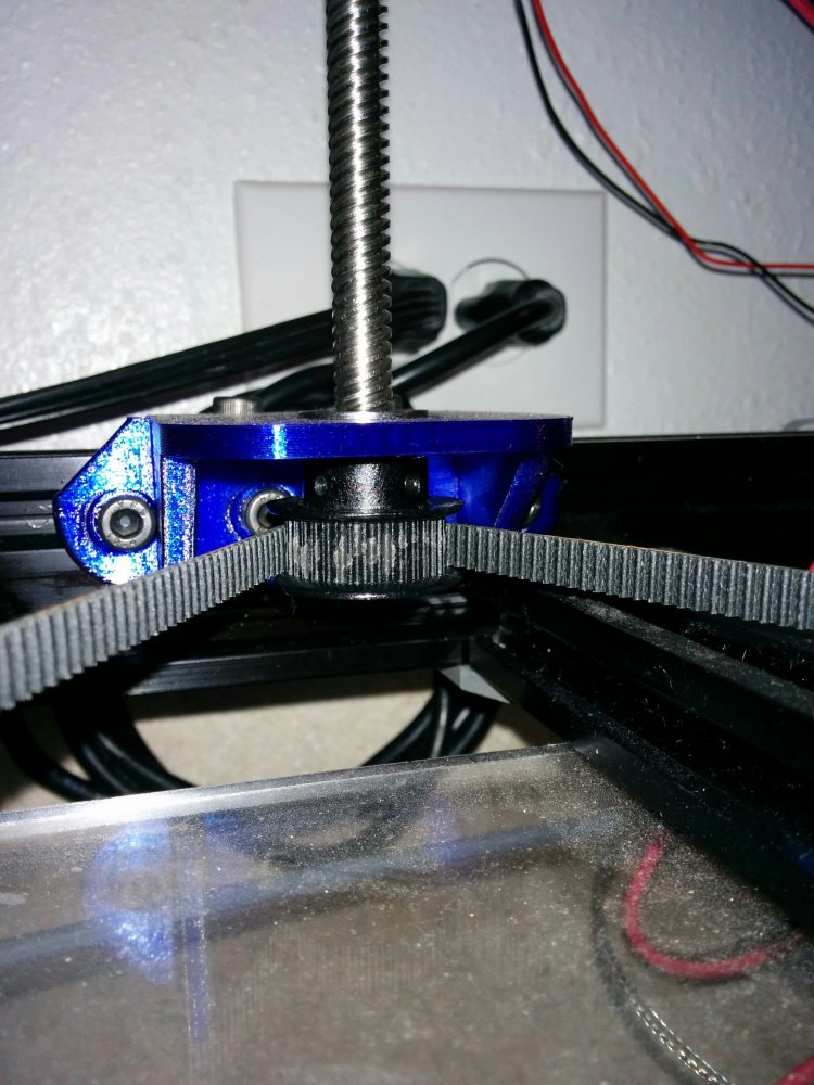

    Sorry it has taken me so long to respond to your requests, after a build hiatus due to cross country move, I had tuning hiatus due to renting a house with bad juju and deciding to buy another house here in Cali. So, I find myself just unpacking "printlandia", as my wifecountant calls it. 2/3 printers set up and my clone printing a caliblock . Hopefully I can get up to speed over in the C-bot thread, I had a google now card pop up about a big switch to direct drive.
    Some pics of my leadscrew mounts. My 8mm leadscrews are turned down to 5mm shaft 20mm on each end. You are correct that the bearings are not rated for axial loads, my test placed 5Kg of filament on the bed and had no difficulty homing ( other then timing out ). I will pose the question over in the google group and see what folks much smarter then I have to say.
    IMG_20151110_010159.jpg IMG_20151110_010206.jpg IMG_20151110_010215.jpg IMG_20151110_010221.jpg IMG_20151110_010239.jpg

  26. Austin Seagers
    Austin Seagers Well-Known
    Oct 13, 2015
    88
    48
    No worries! At least you're back up and running...
    Thanks for the pictures. If you could link to the google group/thread you mentioned I'd appreciate it.
    And regarding the bearings. It sounds like you had it wrapped up already. 5Kg sounds plenty capable. I suppose the only issue I could foresee is a slow wear and widening of the bearing grooves in between the races resulting in play in the Z axis.
    Nothing to be worried about though i'd imagine.

    Typically a ball type bearing and handle ~25% axial load relative to it's radial capacity.

    My kitchen brain said "order the biggest bearing you can find with a 5mm ID"
