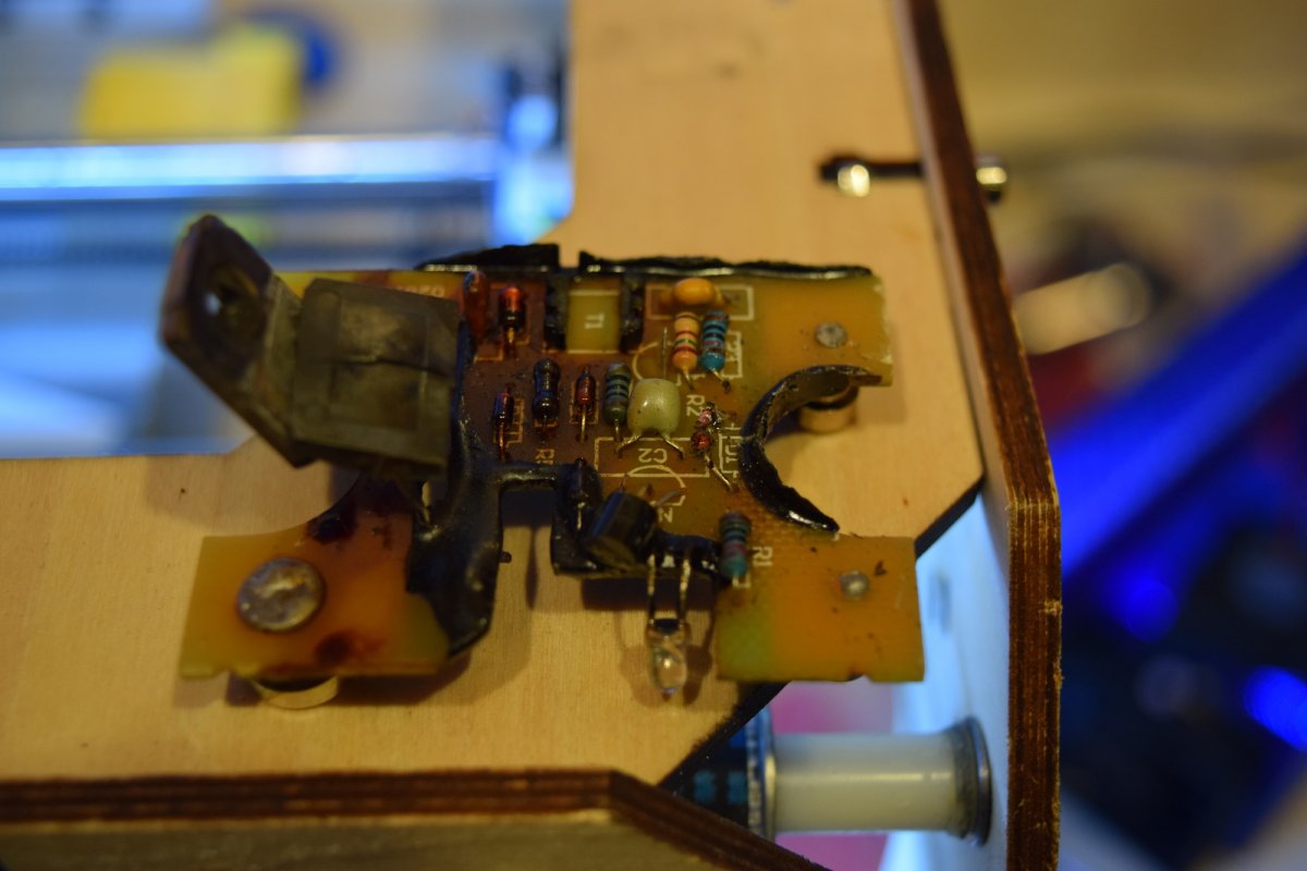

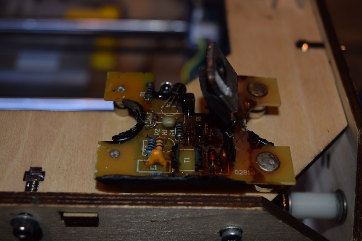

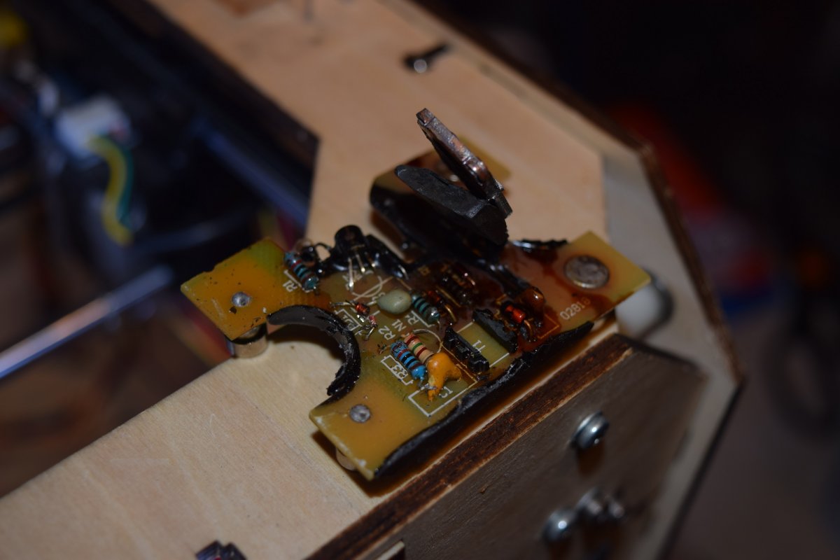

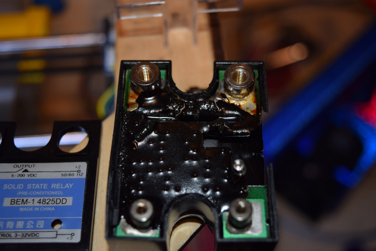

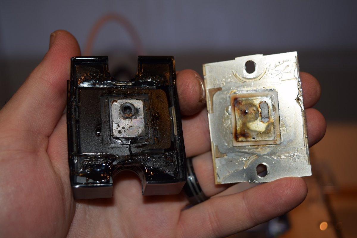

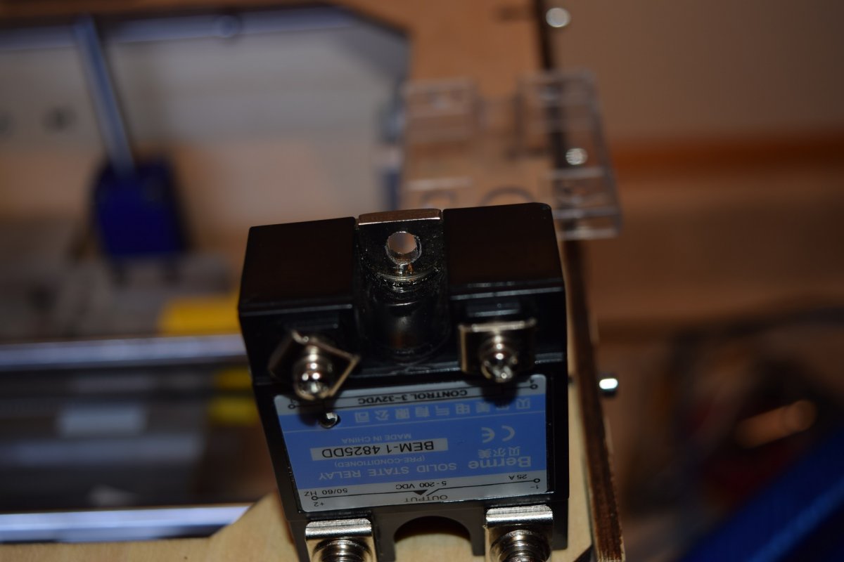

    I did a post mortem on my smoked DC-DC SSR. I did definitely go bad. It was preheating to ABS temps, why im not quite sure, this large of a bed, in a cold basement, heating to 110 just pulled too much power for it to handle and it fried. It took about 10 minutes of preheating to do this. I replaced it with another, while I wait on a more permanent solution, about 80C it was very hot. I could barley touch the base of the heatsink, and touching the base of the SSR, singed the skin on my finger. I am a chef, and have 27 years of tempering my nerves against heat. I can touch very hot things, especially momentarily with my fingertips.

    Are you switching DC? A MOSFET or array of MOSFETS will probably do better at those temps and cost considerably less.

    I am switching DC, and now I know that should use a few fets for this. I think I may also switch my bed to a 24V unit. Less Amps with more Volts.

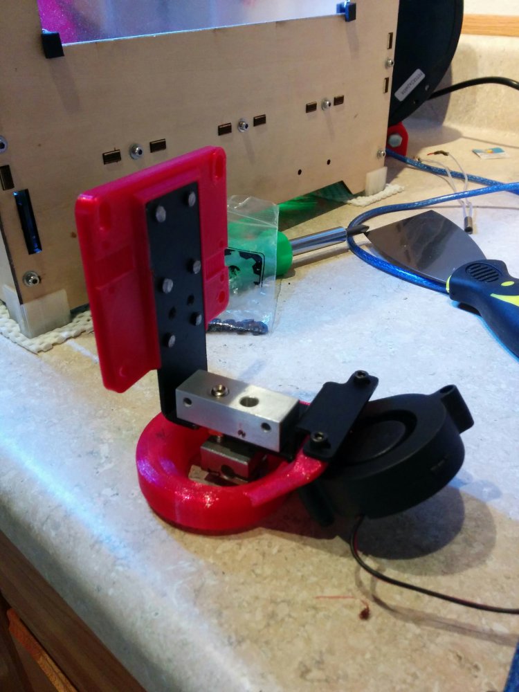

    Just finished modeling up the new gantry plate, which will use a off the shelf i3 extruder bracket. I will get it printing in the morning, maybe get it installed this weekend.

    Well, for the layman, a MOSFET is a switch (transistor) that is operated with the presence or absence of a voltage at an electrical "gate" connection. In this case, you would switch the transistor on and off with your regular heated bed power output.
    MOSFETs can be bought already mounted to a circuit board with the relevant connections available on connectors and are available in a massive amount of voltage and current capacities/ratings.
    I purposely left this a bit open-ended as it does require a bit of prior experience to implement as they're significantly less fault-tolerant in numerous ways than a solid state (or mechanical for that matter) relay.
    As a guide; an ~80A MOSFET of suitable voltage rating can be bought from RS/Farnell for <£2 in as low as single digit quantities.

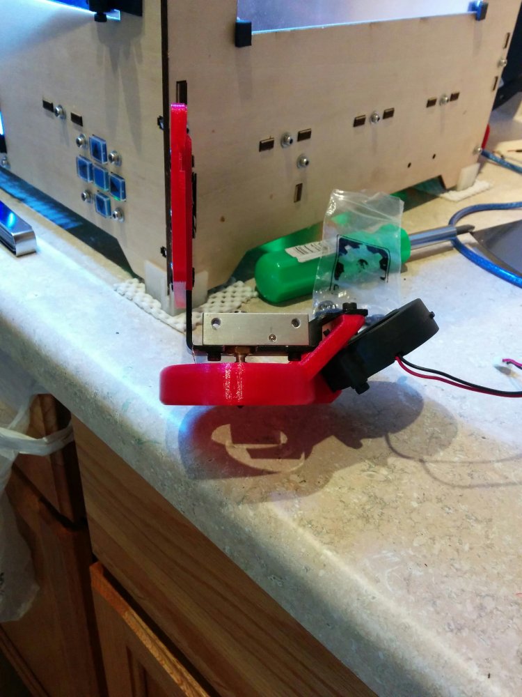

    Just finished up the new gantry and extruder mount. This one feels more solid then the others that I have used. I am hoping it plays nicely with the volcano block as well. Maybe I will get it installed tonightish, still waiting on my FET controller.
    covered in the discussion here . Coming custom from Jetguy. I may try to convince him to help me produce a good board for this to host on oshpark.

    Looking good! Are you planning on wrapping the hot-block with some kapton?
