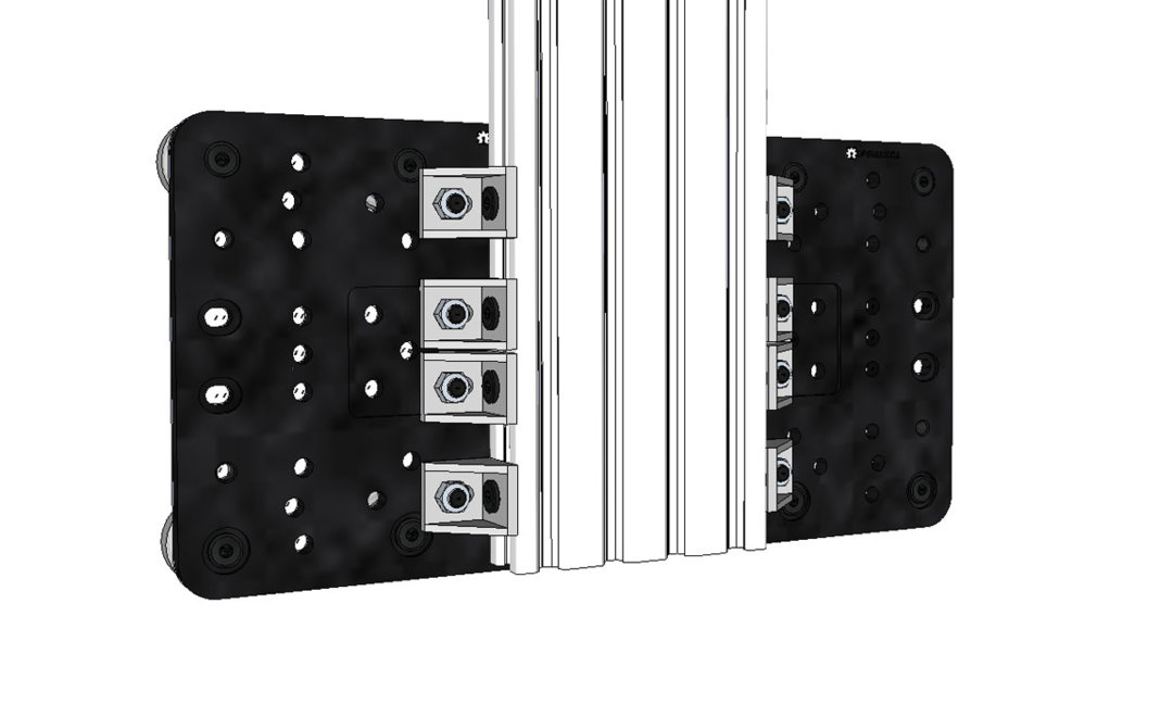

    Nice design. May have a bit of a rigidity issue in the frame over the top. To help resolve that I would suggest laminating another piece of 20x80 to both ends of the gantry, extending from the top of the upper C-Beam to the bottom of the side gantry plate. Clip it to the gantry plate with right angle clips and provide additional connection plates at the top to the end of the C-Beam. You might also take a look at how the side gantry plates work on the CRH C-BEAM Router, steel capable. This would greatly simplify your build and do it at a slightly lower cost.

    Thanks for the input, the gantry is still a work in progress. not sure if i will be using actuators or linear thrust controllers for raising and lowering the roller. rigidity was definitely a concern with the gantry. the force pushing down on the roller will be roughly 25-30 lbs, no more.

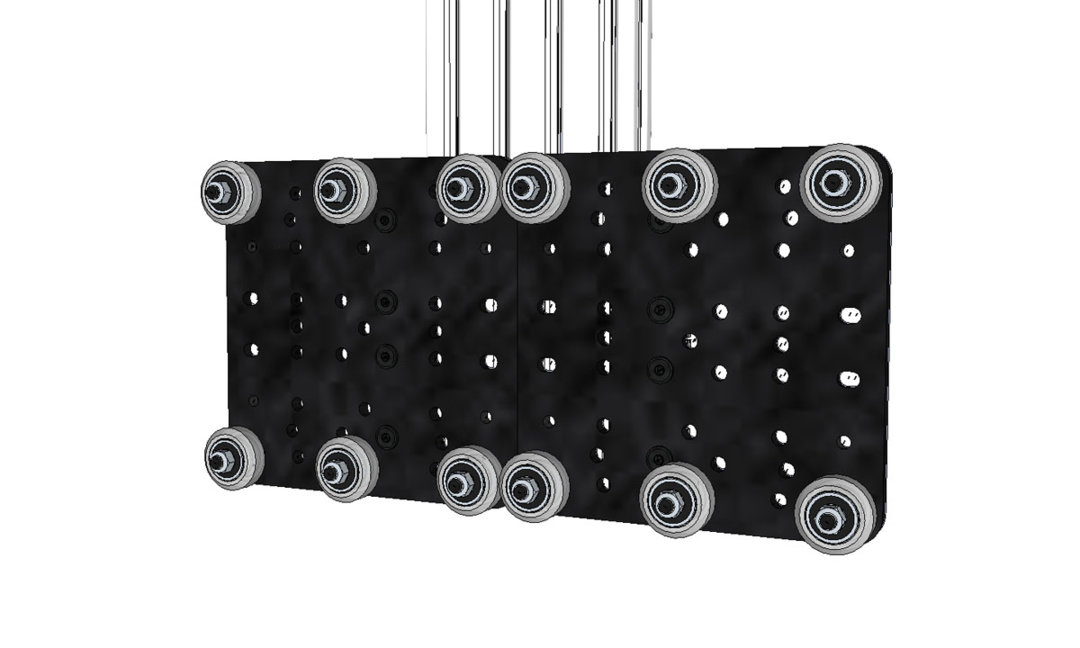

  12. Rick 2.0
    2,912
    1,575
    With proper gantry plates you shouldn't have any issues pushing down on the roll with 25-30 pounds of force. Simple concept shown below using XL Gantry Plates.
    Note, 20x80 framing shown but using C-Beam sections for the verticals may provide stiffer joints at the upper connections.
