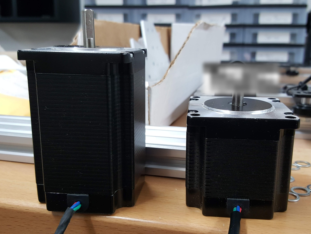

    I have a question that came up while installing my NEMA 23 High Torque steppers which I ordered 4 of.
    After unpacking them and during installing. I find that I have three (3) that are 2303HS280AW-OB and one (1) that is a 2315HS300AW-OB. Is this going to cause a problem when setting up the machine with the xPro V-4 since one is a 3 amp/phase?

  23. Rick 2.0
    2,902
    1,557
    Only one of those sounds like a high torque stepper. Is there not a noticeable difference in size between the two models?
  24. Armadillo Works
    Jan 31, 2019
    30
    19
    The length of all four of the steppers is 3-1/4" (83mm) which is bigger that the standard Nema 23 on the parts store site. I really would like to know since I paid a premium to get the high torque steppers.
  25. Rick 2.0
    2,902
    1,557
    If they’re all 83mm long then it sounds like whoever etched the numbers on the end made a mistake. The real 2303HS280AWs are the 175 oz-in steppers and are only 57mm long. You might check with the shop to verify but you can probably assume all are 3 Amp 2315HS300AW steppers.
  26. MaryD
    MaryD OpenBuilds Team
    Apr 13, 2016
    649
    639
    OpenBuilds High Torque is about 85mm tall. Significantly taller than standard NEMA 23. If you did not receive what you expected, we'll make it right! Just contact customer service at http://support.openbuilds.com/support/home ht vs nema 23_2.png
  27. Armadillo Works
    Jan 31, 2019
    30
    19
    Mary,
    The steppers that I received; three (3) that are labeled 2303HS280AW-OB and one (1) 2315HS300AW-OB. All four steppers are 83 mm in length. The confusion is caused by the labeling on them. The other issue being able to set them up for the correct current rating. Is there any way to test or verify their ratings.
    Thanks!
    Roger
  28. MaryD
    Apr 13, 2016
    649
    639
    Same height = same motor. Discovered that some of the motors had the incorrect part number lasered onto them at the manufacturer. The correct part number for High Torque motors ends in 300. Apologies for any confusion!
