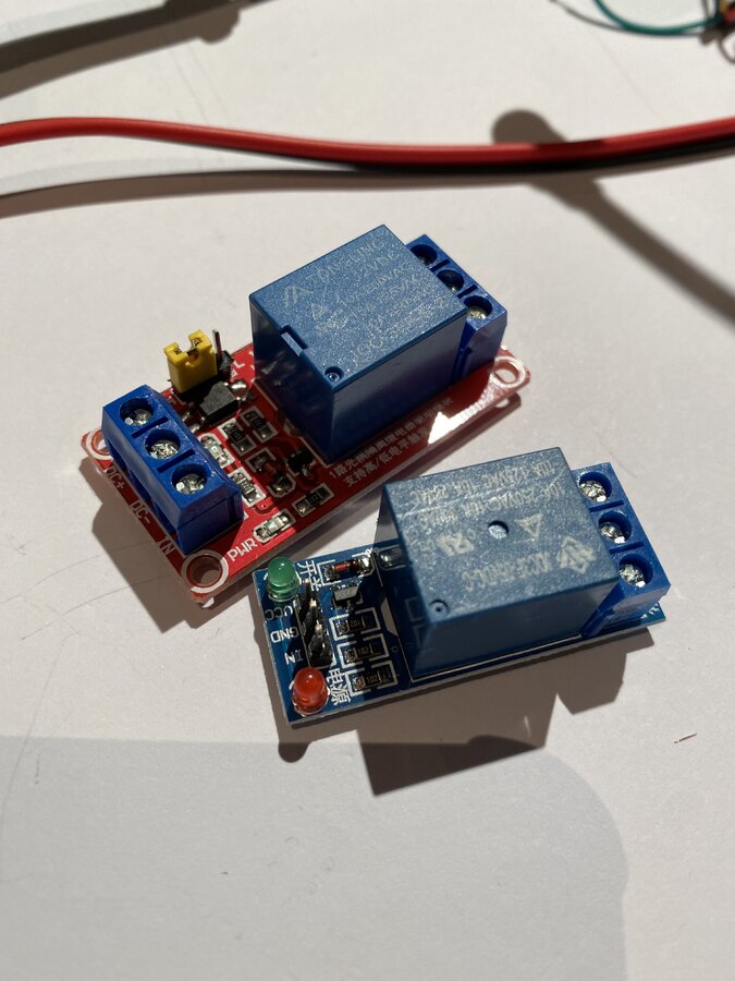

    What about the best way to use these to switch 20V 1A (if you don’t advise to switch 240V) (one is 5V other 12V coil) ? Tia
    Builder Resident Builder
    15,700
    4,502
    They need an external PSU to power the coils, but at least some of those do have opto couplers. Blue one does not.

    I am seeking to turn a 20V 700mA DC light and a 5V fan on and off from the Control interface. Is there no easier way, using the onboard relays?
    If not, they could be switched by relays on the DC line side, or on the AC side of the 240V transformers that provide this DC. But I can't find an off the peg IOT relay rated for 240V.
    If I have to power the relay coils with a secondary power supply, then how do I switch that on and off? It become infinite loop, no? Unless the relays are permanently powered.

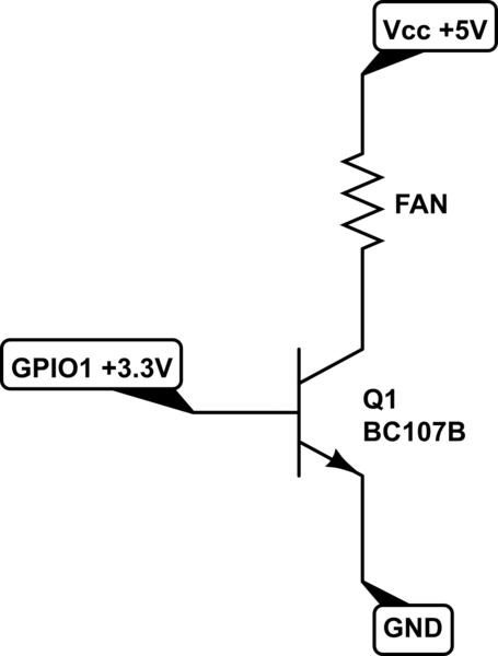

    Please elaborate on the use case, as its not standard stuff, but:
    Would it run off 24V? Coolant Output is convenient for that.
    If you need to switch it on/off theres nothing onboard to do it easily, but needs nothing more than a simple NPN transistor to switch the low side off the logic signal.
    Neither of these needs mains switching. :) Pays to give us much info intially so we can answer properly :)

    The Led has its own 20V 700mA constant current power supply, from a 240V transformer. I just want to switch that on and off from the tool control in the interface. Either by interrupting the DC line or 240V supply, don’t care which.
    Either by my own 5V or 12V coil relay (I have both) signalled by the X32.
    Or alternatively directly through the relays in the box (assuming not as 700mA is too much for them).
    The fan similarly.
    I dont need power to run the led or fan; just my relay coils, if I can’t use the onboard relays directly.
    What I dont understand is the best output from the X32 box to signal the relays; and if there is a reliable 5v or 12v source to tap to run the coils.
    I dont have access to an off the shelf 240V iot relay; just arduino type boards.
