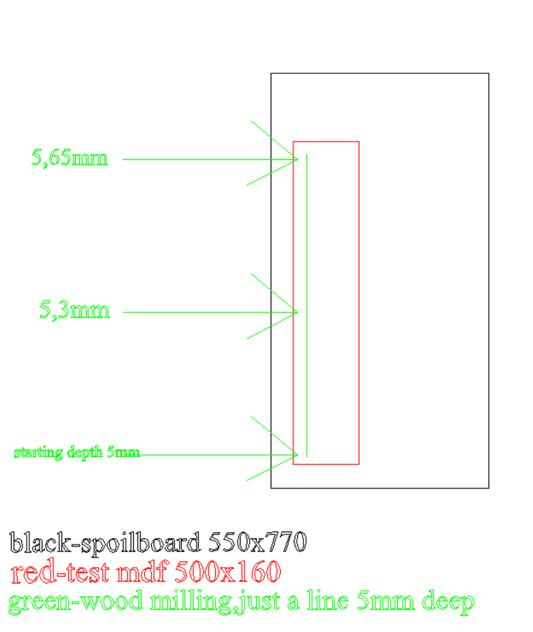

    Hi everyone,i just finished my spindle tram.I surfaced the spoilboard,its flat,no visible toolmarks,looks& feels flat.This is my second surfacing because when i first surfaced the spoilboard it was bad,alot of tool marks because the spindle was not tramed i think.So after all i tried to make a long 500mm single line test cut with the depth of 5mm.At the starting point it was 5mm but at the end it was like 5.65mm in the middle 5.3mm.I checked the 4 corners of the machine and its flat.I made a quick illustration about the situation.

    What controller are you using, what are your configuration settings, what spindle/router are you using?
    There are many possible causes of this - we will have to try to eliminate them one at a time. Check that the motor coupler on the Z axis is not slipping.

    Am using a black box controller, the cut was done with 2200rpm,30mm/s and depth of cut 2.5,using a 1.5kw vevor water cooled spindle.
    I will check the motor coupler later today.Thanks for the fast reply!

    So i made some changes.The motor coupler on the z axis is good.$1 is 255.I re-calibrated all the axis.The x,y axis are perfect.I also tried out something.I made a drilling program.I drilled 3 hole along y axis and the depth of all the 3 holes was spot on! But when i tried to mill a square the depth was off, the dept has to be 3mm.

    Something is not clear for me,if the x rail is bending while the machine is working than how is my spoilboard flat after surfacing.I mean if there is like 0.65mm diference in depth.There will be noticable lines on the spoilboard or am wrong?

    Today i checked out the x axis profile and its not looking so straight.Also as you can see in my older post,the milling gets deeper on the right side, but i dont get the front to back depth diferences...

    Are you measuring the depth relative to the top of the stock?
    If so, did you deck off the stock with a surfacing operation?
    if not - what you are seeing is just standard material deviation - that sheet is not going to be micromillimeter precision thickness all over - its going to have high and low spots

    My Z0 is on the top of the material,and no,i did not surfaced the material...Tomorow i wil surface the top and then i will make a test drill holes and milling.I completly forgott this possibility.
